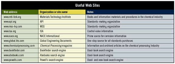

It would be nice if all this valve information was available online. But so far only a smattering of easily obtainable data is available. Most of what exists is available on manufacturers' Web sites. Many of these sites now offer PDF catalog and document downloading.
