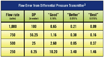

"Good, better, best" compares the transmitter total performance (includes reference accuracy, static pressure, temperature and drift) of one 0.1 percent and two 0.075 percent reference accuracy devices.

The next step is to quantify the impact of these real-world conditions for the given application and transmitter of interest. For DP flow applications, reputable instrument suppliers publish specifications that allow the user to calculate and predict the impact of these and other "real-world" effects on installed flow accuracy and repeatability.
The results under "typical" installed conditions are shown in the table. Although these errors might seem small at 100 percent flow, the errors are magnified at lower flow rates for two reasons.
First, any error remains fixed over the entire transmitter range. For example, consider a 1-mile per hour (mph) error in your speedometer. At 100 mph, this is a 1 percent error; however, at 10 mph, it becomes a 10 percent error.
Second, for DP flow applications, flow is equal to the square root of DP, meaning flow errors increase exponentially at higher turndowns. For example, 1/2 flow equals 1/4 DP, 1/4 flow equals 1/16 DP, etc. Many suppliers offer software tools that allow users to quantify the installed repeatability for specific transmitters in specific, user-defined application conditions.3
Two conclusions can be made from the table:
Reference (laboratory) accuracy is a trivial component of total transmitter installed error.
Two DP transmitters with identical 0.075 percent "reference accuracies" can provide dramatically different installed accuracies. CP
