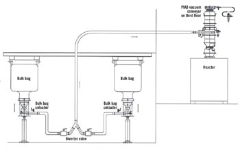

A pneumatic seal forms a dust-free connection between International Specialty Products' bulk bags and its unloader, which helps freely flow product toward the air-driven vacuum conveyor.
Flexibility through modularity
Gaining a complete solution at a cost-effective price was what attracted ISP to the PIAB system itself. But several key features of the system ," such as its modular design, which enables the bulk bag unloader to be mounted remotely away from the conveyor and other flexible options ," also made the system stand out.
In ISP's case, the unloader sits under the hanging bulk bag with the spout of the bag attached to it. A pneumatic seal forms a dust-free connection between the bag and feed assembly for the vacuum conveying system. The feed assembly's nitrogen-fluidized cone, which fluidizes the powder and inerts the transport piping, helps flow product toward the feed point.
If ratholes form in the bulk bag, the cylinder extends, lifting the feed assembly up into the bag, breaking bridges in the material and allowing fresh material to flow. The cylinder can be raised and lowered manually or automatically.
Another notable design point of the system is its vacuum pump, which is driven by compressed air and features high flow rates and deep vacuum down to 27 inches Hg, low energy consumption and minimal noise. Plus, the stainless-steel conveyors are hygienic, resist corrosion and are 100 percent pneumatically operated, eliminating the need for an expensive explosion-proof electrical rating.
