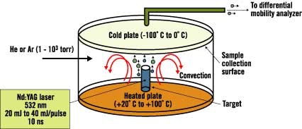

Dr. Samy El-Shall, a professor of physical chemistry in Virginia Commonwealth University's (VCU) Department of Chemistry, says VCU researchers have been perfecting processes that use laser vaporization to synthesize nanoparticles of controlled sizes. See Figure 2.
Figure 2. Laser Vaporization Controlled Condensation
Shown here is the experimental setup for nanoparticle synthesis using laser vaporization in a convective atmosphere.
Source: Dr. Samy El-Shall, Virginia Commonwealth University.
Researchers start with a bulk alloy material, says El-Shall, or make a specific target based on the composition desired. "These are large particles, 100 m," explains El-Shall. "We take the different composition we want to make from this powder, mix it and compress it under high pressure to form a target."
The target then undergoes laser vaporization. "We call it a tailored target," explains El-Shall. "The number of atoms [the laser] will reduce will be proportional to the composition that you have in the target."
The target is vaporized into metal atoms that will tend to form nanoparticles, says El-Shall. "When [we] vaporize, we don't want them to diffuse," he emphasizes. "We want [the atoms] to condense under our conditions before they go away from each other. So, in this case, you form new particles from the condensation of these atoms, and these new particles will not be just iron, just aluminum and just nickel ," they will contain three atoms in the composition we desire."
The composition often is not precisely the desired composition, El-Shall stresses, so researchers adjust it through trial and error. "It really depends on the physical properties of the metal atoms and the diffusion coefficient," he notes. "Sometimes if you have two different metals with very different properties, one diffuses several ," or 100 ," times faster than the other. In this case, you have a problem ," they will not be together at the same place at the same time. You can compensate for that in the composition. Sometimes we have to start with something like 80 percent of A and 20 percent of B to get the nanoparticles 50/50," he adds.
