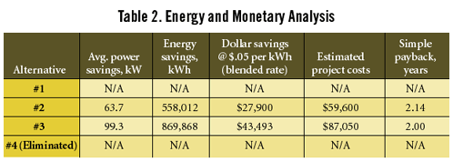

An energy and financial analysis is needed to rank the options further. Many financial benchmarks can be used to evaluate alternatives. For this discussion, simple payback is used. See Table 2.
Table 2 indicates that Alternative #3 has the shortest payback, but Alternative #2 also has a relatively short payback and requires less capital. Further evaluation of project life expectancy, dryer enhancement, possible salvage values, tax credits, future energy costs and future changes in the demand profile also should be considered before making a final decision.
