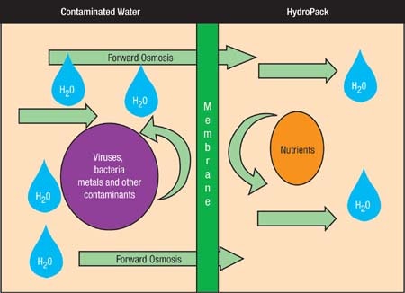

 Forward Osmosis: How it works  When dirty or contaminated water contacts one side of HTI&rsquos semipermeable membrane while a concentrated sports-drink powder or syrup contacts the other side, clean water immediately begins to migrate through the membrane. This is forward osmosis (FO) at work (Figure 2). Acting as a molecular sieve, the HTI membrane allows water to pass into the interior of the bag, while rejecting a variety of organic and inorganic impurities.
The HTI membrane is a rugged composite. An ultrathin (10 µ) FO layer is sandwiched with a microfilter and a fabric backing, which provides strength. With pores measuring 5 Å(0.0005 µ) in diameter, the FO layer successfully filters E. coli bacteria, anthrax spores, viruses, heavy metals, suspended particles and other health threats.
Forward osmosis is normally a very slow process since it is not driven by hydraulic pressure. The HTI membrane allows water to pass at a much higher rate (as high as 1 L/hr in some of the personal hydration systems) because the FO layer is so thin. Also, since it is made from cotton-derived, cellulose-ester plastics, the FO layer is extremely hydrophilic. This allows water to pass through easily, accelerating the filtration process.

Figure 1: Forward osmosis allows clean water to pass through the membrane, while viruses, bacteria and other contaminants are left out. The rotor/stator agitator on the triple-shaft mixer creates more intense shear than that created by a dual-shaft mixer. It also provides more versatility. Each agitator is independently controlled, and each offers a range of capabilities that complements the other two agitators, which significantly extends the overall range of the mixer. (See sidebar: &ldquoTriple-Shaft Mixer Anatomy.&rdquo)
Figure 2. Water spontaneously diffuses into HTI's X-packwhen a generic sport-drink powder is in contact with theinner, clean side of the membrane. It requires no energyand no moving parts.Ross&rsquo triple-shaft mixer is a closed-batch system; most applications include vacuum and thermal control with hot oil, water or steam circulating in a jacket surrounding the mix vessel.  The vacuum proved unnecessary for HTI&rsquos application, but thermal control was important because the cellulose acetate polymer is heat-sensitive. When it overheats, it melts and forms a smeary plastic. Since the system is closed, very little solvent was lost due to evaporation during the mixing cycle.  Triple-Shaft Mixer Anatomy
