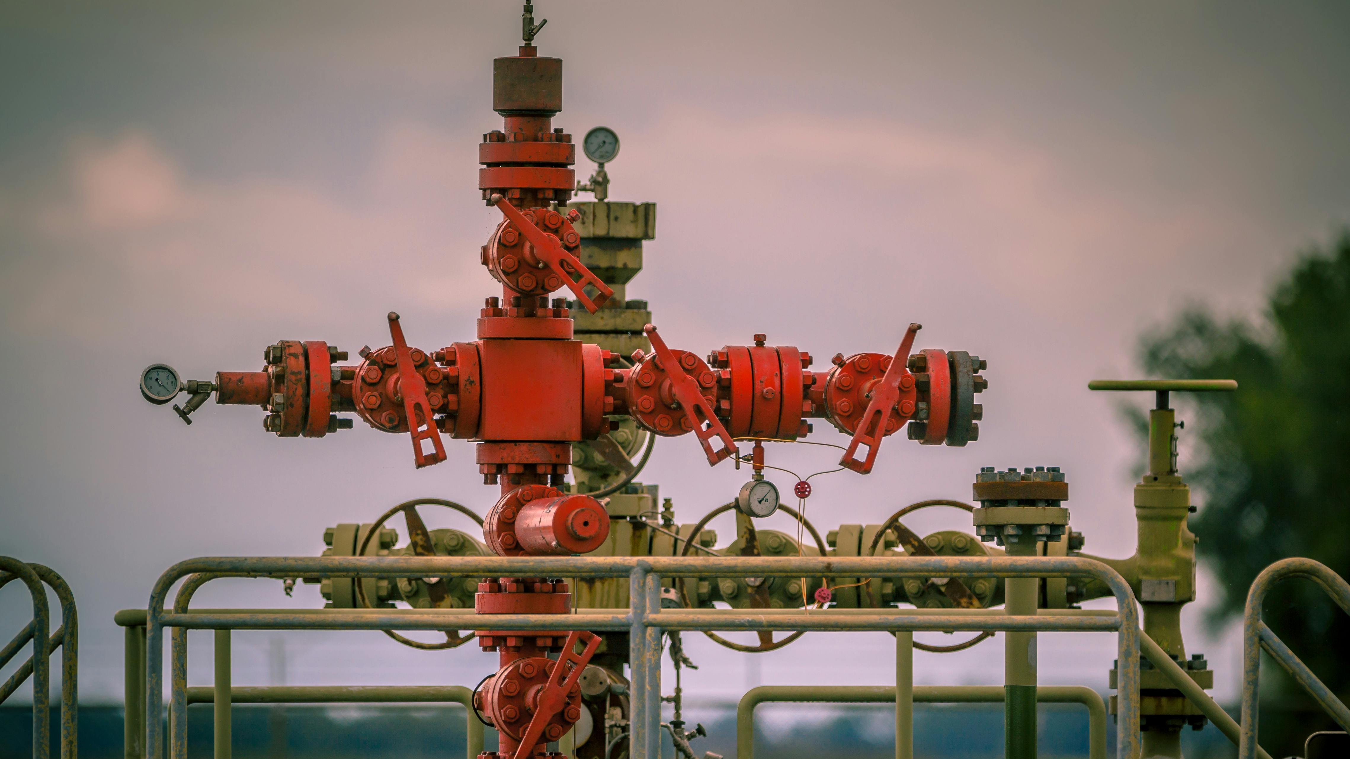

The company submitted its root-cause analysis to the Colorado Energy and Carbon Management Commission on Tuesday and then released a two-point explanation, saying an on-site contractor performed “improper assembly of the installation equipment for the production tree.”
A production tree is a mechanical structure placed on top of a wellhead after drilling and serves multiple purposes, including regulating the flow of oil, gas and water from the well, said Patricia Errico, a Chevron spokeswoman based in Colorado.
Chevron also blamed “inadequate setting of the barrier (tubing hanger assembly) designed to prevent the flow of liquids,” which is meant to serve as a pressure barrier to prevent uncontrolled flow of fluids, Errico said. Chevron did not blame the contractor for that work.
