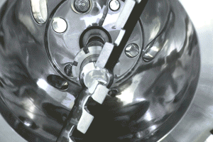

Depending on the application, the agitated filter dryer might use either cloth (generally polyethylene or polypropylene) or metal mesh media; a manufacturer might even alternate between the two. The filter media can be held in place by bolts or clamps, and the metal mesh has the added option of being welded. Most advanced designs now use a boltless mechanism to secure the filter media by simply clamping it between the two halves of the filter dryer. This also provides a sterile design, says Chad Ranpuria, process manager for Powder Systems Ltd. (PSL), Liverpool, England. Cloth filter media is more likely to be used when processing specialty chemicals. Although many pharmaceutical manufacturers prefer metal mesh since product can more easily be recovered, cloth is ideal when used for single runs. The types and pore sizes of filter media that are available are continually expanding, while the cost is relatively stable, Ranpuria says.
Agitated filter dryer vessels separate into two pieces to allow access to the vessel internals, mainly for changing or repairing filter media. The two parts are generally sealed with an O-ring and can be held together with bolts, C-clamps or a bayonet closure (Figure 1); these last two are easier to assemble.
Once the vessel is charged with slurry, pressure is either applied from the top of the filter dryer using a gas, such as nitrogen or compressed air, or a vacuum is pulled from beneath the filter media, thereby forcing or pulling liquid through the cloth or mesh. Low pressures are generally used (1 barg to 2 barg) to keep the cake from becoming so compressed that the crystals fuse together. The liquid exits at the bottom of the vessel where it might be recycled or reused in another part of the process.
While the crystals are collecting on the filter media, the smooth edge of the agitator acts to smooth the surface of the cake so there are no crevices. The other edge of the agitator, which can rotate in both directions, might have teeth for digging into the cake to help break it up and remove it from the filter media (Figure 2). The cake might be broken up and washed several times to remove all trace solvents or impurities.
The powder is then dried by applying heat to the vessel. “Heating has become more sophisticated and efficient,” Ranpuria says. Not only are PSL’s filter dryer vessels fitted with jackets on the walls and top dome, but the agitator shaft and blades are also heated, providing direct contact with the powder. Several vendors’ designs also supply heat to the bottom filter plate.
Lewis Fabricius, P.E., manager of reactor systems for Pfaudler Inc., Rochester, N.Y., says the company’s design speeds drying by using an internal heating grid that directly conducts heat to the product. The company also offers an optional heated nitrogen distribution system, which can fluidize the cake, thereby reducing drying times.
