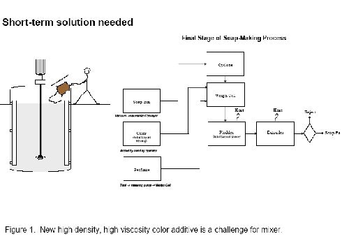

The research department is introducing a new color additive. This additive is blended with a 2-hp high-sheer mixer prior to addition to a weigh-cell feeder (Figure 1). The feeder drains to a soap plodder (mixer) and eventually product is extruded as bar soap. The specific gravity of the new liquid is 20% higher and viscosity is 10-times greater than the additive used in the past. Calculations show that the power draw by the high-shear agitator will exceed the motor limits. Because the new product will roll-out in a few weeks, we need a short-term solution — quick. What alternatives will allow production to continue?

Add a portable mixer
Consider mixing with a portable mixer with a marine impeller. This type of impeller produces more flow than a high shear mixer — with less horsepower. An alternative might be to feed the high shear mixer with the portable mixer. At our plant, we had similar problems. Where we could not resolve the problem by modifying the process, we decreased the size of the blade by cutting some of the metal off the blades of a turbine impeller. This decreased the load on the motor. This must be done carefully to avoid a torque problem from an unbalanced impeller. We added re-circulating lines in our tanks, so we were able to eliminate dead spots on corners of the tank. Generally, soap-making has heat available (steam or electric) at hand so heating the tank might help resolve the problem. It might also be worth looking at heating the concentrated colorant, if it is in liquid form. Eventually, a different mixer should be considered.

Reduce the mixer speed
Borrow a harmonic drive system, if available, to reduce the motor speed. High shear mixers are typically direct-drive, without a gear reduction. Reduce the speed since the power required by the agitator is related to the speed by a cubic function (P = 6.566 × 10-14 (NpN3D5r) reducing the speed by 20% will decrease the power draw by more than 50%. (Np is the manufacturer’s power number, N is the speed in rpm, D is the impeller diameter in inches and r is the solvent specific gravity.) Reducing the speed will have the less effect on the mixing time than reducing the diameter because the flow will be only slightly affected (Q = ND3Nq/231).  (Nq  is the impeller flow number and Q is the pumped flow in gpm.) The shearing action will  be decreased, however by reducing the speed. The only problem may be the mounting plate and shafts, which might be difficult to machine in time. Another idea is to relocate the agitator off-center. This will reduce the power draw.

Try a three-prong approach
First, have research conduct some experiments on the final color solution which includes the new additive. If the additive is non-Newtonian, the color solution may be shear- thinning. Ideally, the result of the experiments should be a shear rate versus viscosity curve at the shear that the additive will be subjected to in the high shear mixer.  It will be difficult to be exact on the shear. Talk to the manufacturer about tip speed. Ask them to look at ways to reduce the viscosity and density in the solvent.
Second, assuming non-Newtonian characteristics, consider processing at a higher temperature. Viscosity is a function of temperature and is often inversely proportional to temperature. Have research provide a shear rate vs. viscosity curve as a function of different temperatures and re-calculate power draw requirements.
Third, look at ways to reduce the feed rate of the new colorant without severely affecting mixing time or labor costs.

Install a VFD, replace the impeller
At the bare minimum the 20% increase in specific gravity will call for 20% more horsepower, and most likely the 10-fold increase in fluid viscosity will also require additional horsepower. The assumption being that an increase will take us into transitional flow regime in the Reynolds number vs. impeller drag coefficient curve, where increasing viscosity results in increased drag (power draw) on the impeller. The existing mixer will probably not work and if it does, the mixing will take longer. Here are a few options, some of which may be possible with the tight deadline:
  1. If mixer is equipped with a variable frequency drive, or a VFD is available, perhaps the mixing requirements can still be met by slowing the mixer shaft draw and shaft speed. The mixer power draw is proportional to the cube of the shaft speed. Therefore a small decrease in shaft speed would result in a noticeable drop in horsepower drawn at the shaft. I estimate that a 7% drop in RPM would be required to account for the increase in density.
  2. Perhaps the "shear" mixer utilizes a "saw tooth" type (a.k.a Cowles) impeller, which is readily available and relatively inexpensive. A number of vendors can supply impellers quickly. If so, we can take advantage of the relationship between mixer motor draw and impeller diameter — mixer shaft horsepower is proportional to the impeller diameter to the 5th power (D5). A very small decrease in impeller diameter causes a noticeable drop in mixer horsepower; roughly a 4% drop in impeller diameter would be required to account for the increase in density.
  3. Check with the manufacturer of the high shear mixer. The power frame of the mixer may in fact allow for a larger-hp motor to be put on the machine and still stay within the mechanical limits of the shaft system.
Shear mixers normally are most effective when their impeller peripheral speeds are in the 3,000 to 5,000 ft/min. range. Dropping the shaft speed or impeller diameter would effect the “tip speed” of the blade so if both new impeller and VFD are available one perhaps could re-tune the existing mixer to provide the proper process result or at worst case make up smaller batch sizes.

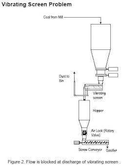

A vibrating screen separates pulverized lumps of coal from dust. The screen is fed from a lock-hopper above. The fine particles must be separated because they could become carry-over for a gasifier (entrained-flow); a pelletizer scheme is being tested to re-use this material. The lumps are then fed to a screw conveyor to the gasifier. On a vibrating screen, solid is supposed to be spread evenly across a mesh screen (Figure 2). The rocking motion and the slight slope cause the solid to flow towards the discharge and into either the pneumatic conveyor pick-up pipe or the hopper for the screw conveyor. This isn’t happening. Instead, coal is building up on the screen and blocking flow from the lock-hopper above. The screw conveyor hopper is plugged and the pick-up pipe is plugged. Adjustments to the slope and the rocking motion have been increased to no avail. Any suggestions?
Send us your comments, suggestions or solutions for this question by August 11, 2006. We’ll include as many of them as possible in the September 2006 issue and all on CP.com. Send visuals — a sketch is fine. E-mail us at [email protected] or mail to ProcessPuzzler, Chemical Processing, 555 W. Pierce Rd., Suite 301, Itasca, IL 60143. Fax: (630) 467-1120. Please include your name, title, location and company affiliation in the response.
