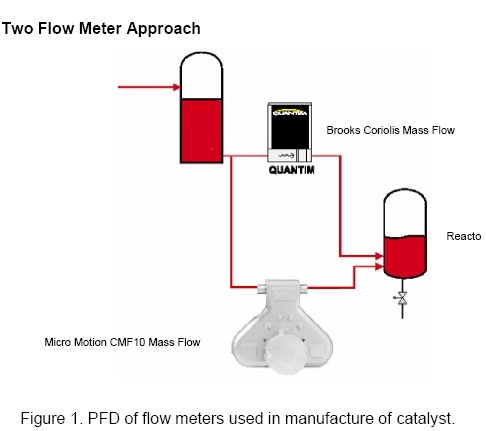

The operating range of the catalyst injection process was 1-1000 g/hr with a line size of 1/8 in. Due to the physical properties of the catalyst, the process was required to overcome one disadvantage: high pressure drop. The pressure drop over the Quantim meter was already 3 bar at 100 g/hr. So, we decided to use the Quantim meter for the lowest part from 20-100 g/hr and use a Micro Motion CMF10 Coriolis meter for the range from 100-200 g/hr. We also designed the process so that the Quantim meter double-checked the CMF at the lower flow range. Both meters were installed in series with an automatically controlled bypass and solenoid valve over the Quantim meter for flow rates above 100 g/hr.
Flows of this magnitude are just drops of fluid, and any variation has a major impact on the results of the pilot test. To make sure that the system worked, a small test was performed. The catalyst was pumped through the meter and collected on a scale as it came out the other end. The results were very good, even at the lowest flow rates (Figures 1 and 2).
