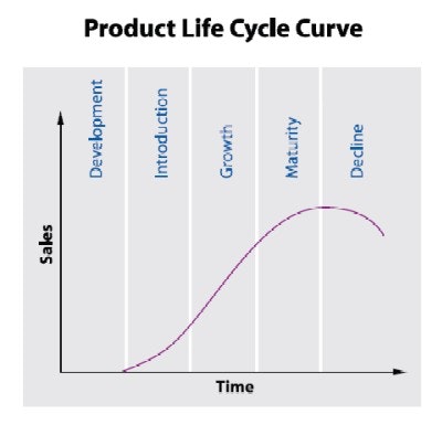

Innovation, whether through the development of new products or processes, has become crucial for companies in virtually every industry. New technology holds the key to competitive advantage and, perhaps, survival. Product life seems to be shorter and shorter (Figure 1).
Figure 1. The lifecycle of a product — to stay in business a company needs a steady stream of new ideas.
