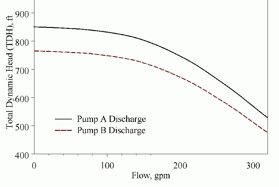

Nominally identical pumps can have different actual pump curves due to dissimilar maintenance histories, tolerances and wear. In some cases, the difference can reach 10% of head generated – Figure 2 shows the impact on flow.
Figure 2. “Identical” pumps can actually differ by up to 10% in total dynamic head.
This is a common problem and was a factor here. While the difference wasn’t 10%, it was enough to force the B pump product out of the intermediate draw nearly all the time when both units were connected. Additionally, small piping differences between the systems imposed a higher pressure drop on the B unit side, making the situation worse.
