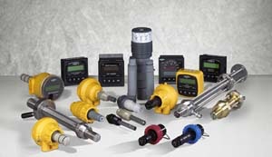

GF Piping System's instrumentation product family.
