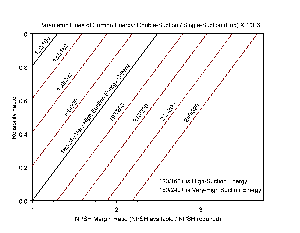

NPSH Margin Ratio
Figure 1. High ESuction pumps only require a ratio somewhat greater than one.
Typical values used to define high ESuction pumps are 160 × 106 for end-suction pumps and 120 × 106 for double-suction pumps. Very high ESuction pumps start at 50% higher than this (240 × 106 for end-suction pumps and 180 × 106 for double-suction pumps).
Figure 1 shows the NPSH margin ratio — NPSHA over NPSH required, NPSHR — for "reliable" operation across a wide flow range when suction recirculation is the problem. (Don't use this figure for situations where suction recirculation isn't the problem.)
Reducing ESuction by using a lower pump operating speed dramatically improves pump reliability. In Figure 1 the boundary for very high ESuction pumps has been defined so that pumps at that ESuction level have very poor reliability unless the NPSH margin ratio exceeds one. High ESuction pumps only need a NPSH margin ratio somewhat greater than one.
While not perfect, the ESuction concept, coupled with the general curve shown, reasonably quantifies both the speed reduction needed and the relative benefit achieved in solving existing pump suction recirculation problems. ESuction also provides a useful guideline to estimate pump cost versus feed hydraulic changes for reliable operation for new installations.
