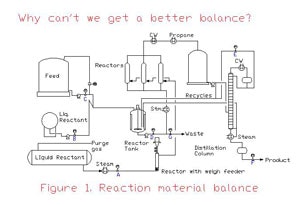

A Difficult Balance
Figure 1. Accuracy issues with seven flow meters hamper getting a good material balance. Our company has been taken over. The new management wants to improve our energy efficiency and accuracy of our material balance (see Figure 1). They’d like to bring the balance to ±1% accuracy. Several flow meters yield questionable data: 1) an orifice meter measuring a wet gas (A in the figure); a vortex shedding meter with a tendency for fouling (B); a meter with a competing recycle line (C); a Coriolis meter with a gas problem (D); a vortex meter with startup difficulties because of gas entrainment (E); a Coriolis meter that measures product successfully (F); and a venturi tube meter that occasionally suffers plugged taps (G). The turndown on the process is about 3:1. How can we reduce our energy consumption and tighten our material balance? Send us your comments, suggestions or solutions for this question by October 9, 2009. We’ll include as many of them as possible in the November 2009 issue and all on CP.com. Send visuals — a sketch is fine. E-mail us at mailto:[email protected] or mail to Process Puzzler, Chemical Processing, 555 W. Pierce Road, Suite 301, Itasca, IL 60143. Fax: (630) 467-1120. Please include your name, title, location and company affiliation in the response. And, of course, if you have a process problem you’d like to pose to our readers, send it along and we’ll be pleased to consider it for publication.Sponsored
