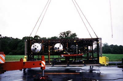

A Good Turn
Figure 1. Laying a modular pilot plant on its side may overcome height restrictions for shipping.

Second, there's a sense a unit can't be economically and safely shipped long distance. Anyone who's ever seen major process units on highways will understand how even incredibly large items can be moved. Of course, as units get larger, routes available get more limited, preparations grow more involved, permits and escorts required more extensive and costs higher. However, most modules can be shipped with minimal problems at reasonable cost if they're properly designed to meet a few easy guidelines.
Most U.S. interstate highways are limited to a 15-ft. clearance. Low-boy air-ride trucks as low as 18 in. are available, thus affording a tight but realistic 13-ft. module height. Widths and lengths are more flexible but, in general, holding lengths to 20 ft. and widths to 10 ft. isn't a problem. Expansion to 40-ft. long and 15-ft. wide, while more costly, usually is an option. Recognize also that a module sometimes can be laid on its side for taller units (Figure 1) or stood up for wider units to meet these dimensions.
Modules must be structurally strong enough to endure lifting and transport. This doesn't mean, as some fear, they always must be enclosed with massive and expensive steel frames. In many cases, proper bracing or temporary supports add more-than-enough stiffness and strength. Other alternatives include crating for smaller modules or shipping skeletons that are applied over the module but removed upon installation (Figure 2).

Figure 2. Modular pilot plant is being unwrapped after a 1,200-mile journey.
While an added expense, these often can be reused or at least fabricated more crudely to reduce their cost. In many cases, standard strut pallets and frames can move across the continent with only minimal extra bracing if properly designed and constructed. Simple tricks like double nutting threaded rods, tack welding joints and clips can greatly increase vibration resistance.
Temporary packing measures, ranging from bracing, lashing, stuffing and wrapping to wooden or metal supports also can work incredibly effectively to reduce the risk of vibration damage. Removal of a minimal number of key components (such as glassware or high sensitivity instruments) also is a viable option if not carried to extremes. Air-ride trucks are readily available in almost any shape or size; these reduce the vibration on modules to realistically controllable limits.
