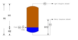

Our decanter for separating a mixture of C10, C20, C30 and C40 compounds from a water/toluene solution isn’t performing right. To save space, we opted for a 3-ft-diameter vertical unit with a length/diameter ratio of about 3:1. The flows are 6,000 pounds per hour (PPH) of organic and 2,500 PPH of aqueous phase. The viscosities are: 300 cP for the organic; 0.8 cP for the water. The specific gravities are: 0.8 for the organic; 0.99 for the water. Feed is at about 50% of the straight side length and we use a dispersion layer of about 5%. Although the decanter is designed to capture 100 micron (µ) droplets, the carbon filter that’s supposed to serve as a water polishing filter actually is removing them. We’ve had to change it out every 30 hours at a cost of $250/500 pounds. On examination, we discovered that during construction 1-in. high-flow packing was dumped into the decanter. It fills the bottom third of the column. How can we fix the decanter? Should we be happy with 100 µ? How can we reduce our carbon costs?

Review your design against the following suggested method. These gravity-based decanters are based on hydraulic balance and have been successfully used for continuous processes.
The density numbers suggest that we should have a quick separation of the organic and water phases. Based on your problem definition, if the nozzle for removal of the organic layer is located at about seven feet from the top straight side, there is sufficient residence time to separate the two layers. Actual time can be determined in the laboratory. The feed location as described should be all right. The following equation can be used to calculate the height of the interface:
H2 = (H12 - Ht (ρ1/ρ2))/(1 - (ρ1/ρ2))
where ρ1 is the light phase density;ρ2 is the heavy phase density;  Ht is the distance between the exits, light and heavy; H12 is the height of the riser in the heavy-phase exit line; and H2 is the height of the heavy phase (see Figure 1).
Vertical Decanter
Figure 1. Sight gauge may not detect multiple rag layers (layers with emulsions of the two liquids). It must be connected at multiple points for effective viewing.
The top of the tank and the water outlet pipes should be connected in such a way that they equalize the pressure so that the liquid does not siphon out. The water outlet pipe should have an adjustable arm so that the height of the water layer can be adjusted. It can be used to control the interface level.
Don’t use the manual shut-off valves in the water and organic outlet pipes to adjust flow and interface layer height.
