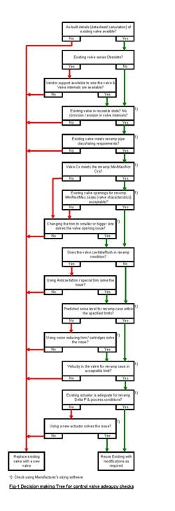

Decision Tree
Figure 1. Assessing the adequacy of a control valve demands a structured approach that considers numerous issues. Download a PDF of this Decision Tree.

Control valves. These need the most attention and time. It's prudent to use sizing software from the manufacturer of the installed valves, to ensure the adequacy check is accurate. Figure 1 shows a decision tree for checking control valves.
Most valve manufacturers keep records of the serial number and valve details in their archives for a considerable length of time. It's important to have adequacy checks carried out or reviewed by the original manufacturer and to carefully analyze its recommendations. Adequacy check reports should record the recommendation for each valve, clearly indicating if the valve is suitable for reuse as is, requires modifications or needs replacement.
The process designer and the end user also should review the adequacy reports and confirm that the process requirements are clearly understood and the decisions made are accurate.
If you're replacing valve internals (trim), the trim material must suit the new process conditions. The method (at vendor's workshop or in-situ) and the timing of the trim replacement need careful planning with the vendor, the owner and the construction team. Inform piping and process disciplines if the new valve has a bigger or a smaller body size valve than the current one.
Existing on-off valves typically are assessed for the actuator sizing for the new shut-off pressure as well as for the revamp pressure and temperature conditions. You must check the mechanical compatibility of the new actuator with the existing valve stem and space if the decision is to retain the current valve body and only replace the actuator.
