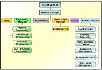

Typical Project Team Structure
Figure 1. This structure usually doesn't enable the most effective use of project controls.
THE PROJECT TEAM
Let's start by defining the roles of a few of the many members of a typical project team (see Figure 1).
The project manager is responsible for coordinating all participants in a capital project. This person should have organizational skills, teambuilding know-how and project execution experience. A project manager motivates, guides and facilitates the outcome of a project. So, the person must be adept at seeing what must be done, deciding who must do it, and ensuring it gets done.
The project engineer expedites the flow of information among disciplines, such as design, environmental health and safety, and procurement, as well as vendors, fabricators, construction managers, contractors, and commissioning and startup personnel. A project engineer facilitates technical resolutions and keeps the technical wheels turning -- allowing the project manager to focus on client, business and commercial issues.
Discipline supervisory staff oversee execution of the work in their field of expertise, ensuring individual workers perform their tasks in a satisfactory manner.
Project controls personnel provide cost- and schedule-performance feedback to all the above team members. They look for problems; investigate, document and quantify them; and bring them to the early attention of the project manager, project engineer and discipline supervisors. The team then can form a consensus on the cause and potential impact of each problem and the appropriate actions to take.
