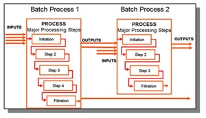

Figure 1. Output from Process 1 serves as an input to Process 2.

The field trial was run on two batch processes -- each made different products. The output of Process 1 was an input into Process 2 (Figure 1). We used 18 input variables, 38 process variables and 4 output variables for the modeling and online analytics. (Many more process variables could have been included but we deliberately kept the scope small for the trial.) Data were collected at 1-min. intervals. We relied upon historical batches for analysis and model development across these two processes.
