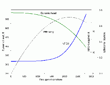

Centrifugal pumps impart velocity to a fluid and then recover the velocity as pressure head. Performance curves depict the total dynamic head generated at a given flow rate for a specific impeller and rotational speed (Figure 1). They typically show total dynamic head in feet, not psi, unless the curves are for a defined liquid.

Pump Curve
Figure 1. Dynamic head in feet doesn't directly give pump power required.
Pump efficiency varies with flow rate. In addition, the efficiencies of the drive system (belts, gears, couplings, etc.) and driver come into play. For an electrically driven pump, the driver efficiency is the motor efficiency. This can vary as a function of total load. Motor efficiencies drop at low loads.
Dynamic head in feet doesn't change as density changes. Imposed pressure in psi and power demand will vary as liquid density varies. For many processes and conditions, the density is well understood and known in advance.
