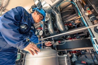

Figure 1. Individual synthesis units eventually could be used in E.U. research projects and by industry collaborators. Source: LUT.
Testing at the Soletair demo plant will continue through autumn. If successful, individual synthesis units then will feature in a number of European Union (EU) projects over the coming years, and as a platform for industry partners to carry out their own research.
