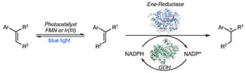

Catalyst Concept
Figure 1. Combining photocatalysts with enzymatic catalysts offers unique opportunities for synthetic chemistry, believe the researchers. Source: Huimin Zhao, University of Illinois at Urbana-Champaign.
Results showed the combined enzymatic catalysts and photocatalysts could be very productive, providing higher yields than could be achieved with enzymes alone. The researchers used the method to create a few active pharmaceutical intermediates. A recent article in Nature contains more details on their research.
