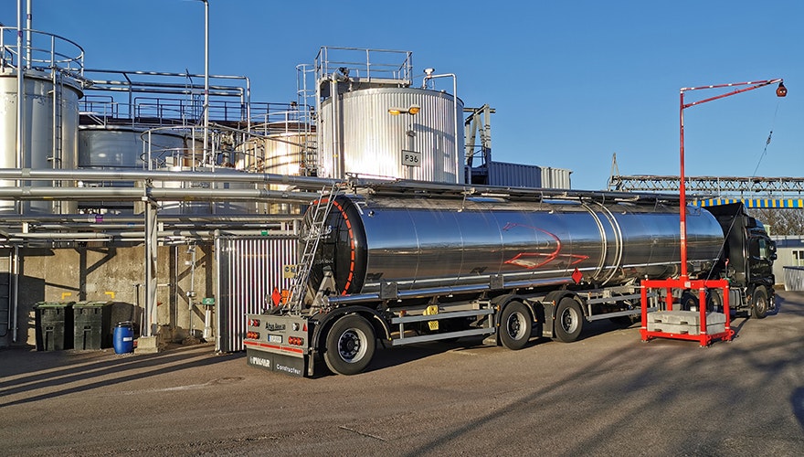

Perstorp has converted production processes at its main plant to solve a Swedish national disinfection crisis. Source: Perstorp.
