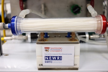

The first, by scientists at Nanyang Technological University (NTU), Singapore, involves a new type of nanofilter that could reduce up to five times the energy needed to treat wastewater.
Typically in a wastewater treatment process, an ultrafiltration (UF) membrane removes small particles from the water before it goes to a reverse osmosis (RO) membrane for final purification. The high pressure needed for RO means the pumps require a lot of energy.
However, NTU’s proprietary nanofiltration hollow-fiber membrane combines both processes into one step. It also requires only two bars of water pressure, yet produces water almost as pure as the RO process.

Figure 1. NTU’s nanofiltration hollow fiber membrane combines both ultrafiltration and reverse processes into one step. Source: NTU.
