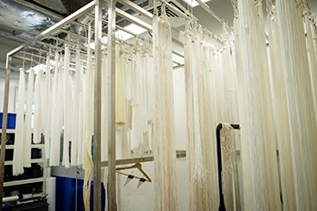

Figure 1. START Centre now is commercializing production of tri-bore membranes, shown here being dried. Source: National University Singapore.

Meanwhile, START already has begun fabricating the tri-bore fiber on an industrial scale (Figure 1).
