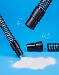

Flexaust introduces the all-plastic FlexStat Static Dissipative Hose featuring an embedded copper grounding wire and conductive PVC cuffs for complete static protection. The FlexStat Static Dissipative Hose is extruded from clear polyurethane with an ABS helix and an embedded copper grounding wire to reduce static build-up.  Featuring screw-on conductive PVC cuffs for added protection and secure equipment connections, the highly flexible and abrasion-resistant hose is suitable for powder transfer and dust evacuation.
The FlexStat Static Dissipative Hose with conductive cuffs allows the grounding wire to make full contact with vacuum machinery.  Made with FDA acceptable materials, this hose is 0.040” thick, provides 108–1010 Ohms/Sq. surface resistivity and comes in 1” to 8” I.D. sizes with cuffs for 1.25”, 1.50”, and 2.00” sizes.  A smooth interior ensures minimum friction loss, according to the company. The hose operates in temperatures from 40°F to 200°F.
