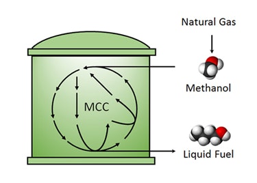

Figure 1. Researchers develop more efficient way to convert methanol to liquid fuel. Source: UCLA Engineering
“Our solution to methanol processing could be a major part of large-scale production that is much lower in cost than current standards,” says James C. Liao, chair of the UCLA Department of Chemical and Biomolecular Engineering and lead researcher on the project.
The team synthesized longer-chain molecules at room temperature and ambient pressure via a non-oxidative glycolysis pathway modified to convert methanol instead of sugar. They used a set of purified enzymes to demonstrate the biocatalytic pathway, termed the methanol condensation cycle (MCC), and were able to produce ethanol and butanol. The process releases no carbon dioxide.
