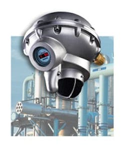

Gassonic’s fast ultrasonic gas leak detection is said to offer a new layer of protection that reduces the risk of gas leak and fire ignition hazards. When combined with General Monitors’ gas and flame detection solutions, ultrasonic technology enhances hydrogen detection efficiency, increasing the likelihood that a hazard is mitigated before it escalates.
The principle of ultrasonic technology is that it quickly detects the ultrasonic noise generated by the escaping gas at a distance from the leak source. A distinct advantage of the technology is that it detects the gas at leak initiation regardless of ventilation rate, gas dilution, or the direction of the leak – and without the gas having to make physical contact with a sensor element.
The detector, which is based on robust microphone technology, has a detection radius for hydrogen up to 8 meters at a leak rate of 0.01 kg/s. In addition, the Gassonic Observer features the Senssonic integrated acoustic self-test, which periodically verifies the integrity of the electronic circuitry and operation of the acoustic sensor. The detectors are SIL suitability rated and hold relevant C-UL and ATEX certifications.
