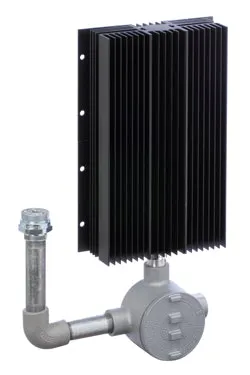

Chromalox has launched the XPMC explosion-proof enclosure heater for freeze and condensation protection in small spaces. The XPMC features an anodized aluminum body protecting a Chromalox cartridge heater and is CSA certified for hazardous locations (Class I, Div. 1 & 2, Groups B, C and D).
XPMC units can be ordered in 6-inch/150 millimeter and 12-inch/300 millimeter lengths, ranging from 120 volts to 480 volts. Units can be ordered with body only or with body and one or two heat sinks. Each heat sink increases the maximum wattage of the unit. The units include two control thermostats so users can tailor the heaters to individual needs. The number of fins can be adjusted to achieve the wattage and temperature rating the customer requires.
