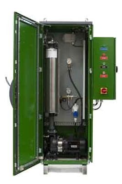

Figure 1. Water passes through a chamber in which ultrasound and aeration kill or impair bacteria.

The patented Sonoxide water-treatment technology works by passing water through an ultrasonic chamber where bacterial cells are exposed to a combination of low-power high-frequency ultrasound and micro-bubble aeration (Figure 1). This kills some bacteria cells and impairs others, reducing overall bacteria levels and eliminating biofilm from the entire cooling-water system.
