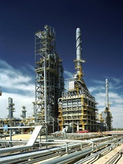

Figure 3 Australian refinery no longer discharges wastewater and uses treated sewage water. Source: BP.

Half a world away, the BP refinery in Kwinana, Australia, (Figure 3) now sends its wastewater to a water recycling plant instead of discharging it into the Cockburn Sound. In addition, the company is taking in treated sewage water from a nearby effluent plant. This water, treated by intense microfiltration and RO, is so pure that it would leach metal from standard piping. So BP has installed glass-reinforced epoxy pipelines.
