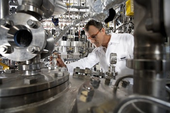

Pilot Plant
Figure 1. BIONEXGEN will allow BASF to build on its existing biocatalysis work such as at this pilot plant. Source: BASF.

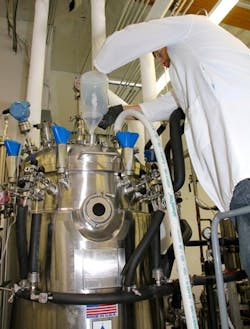

Adipic Acid Unit
Figure 2. Pilot plant employs yeast fermentation to turn non-food plant-based feedstocks into the acid. Source: Verdezyne.

Verdezyne, Carlsbad, Calif., has started up a pilot plant there to make bio-based adipic acid, a key component of nylon 6,6, via a yeast fermentation process that uses non-food plant-based feedstocks (Figure 2). Because of the demand for nylon, the global adipic acid market today is said to amount to more than $6 billion/yr.
"We are excited to achieve this key milestone," says Dr. E. William Radany, president and CEO. "This is the first demonstration of the production of bio-based adipic acid at scale from a non-petroleum source. Our novel yeast platform enables production of adipic acid at a lower cost than current petrochemical manufacturing processes."
Verdezyne's approach reportedly offers a number of other advantages over petroleum-based methods, including less generation of carbon dioxide and other pollutants.
"This plant will allow us to demonstrate the scalability of our process, validate our cost projections and generate sufficient quantities of material for commercial market development," notes Dr. Stephen Picataggio, chief scientific officer.
