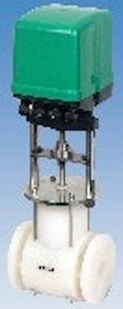

Asahi/America introduces globe control valves
These globe control valves are designed for precise flow control and are available in both pneumatic (air to spring) or electric (115vac 1ph supply voltage), in body materials of PVC, PP, PVDF and PTFE, and in sizes from ½-inch to 4-inches. The globe control valves feature light weight construction, characterized trim for both linear or equal percentage flow curves, and various plug and seat arrangements within a given size valve for maximum control. The plug and seat can be easily changed in the field to accommodate a variety of CV (valve coefficient) values, should the process conditions change.
Drilled to an ANSI B16.5 bolt pattern, the globe control valves are versatile and can easily be installed in both thermoplastic piping as well as metal pipelines.  Being of thermoplastic construction, these valves are highly corrosion resistant and are suited for aggressive chemical applications in such industries as chemical processing and waste water treatment.
