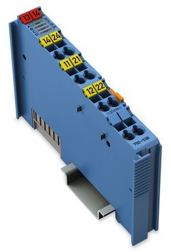

Via internal system voltage, Wago Corp.’s new two-channel relay output module directly activates intrinsically safe circuits, powering actuators in hazardous locations. Unlike traditional solid-state hazardous location relays, the 750-538 carries two changeover contacts for activating zone 0/20 and 1/21 devices, such as relays, solenoid valves, contactors and optical/acoustic signal generators. This supports diverse hazardous location applications in oil/gas processing, wastewater treatment, brewing/distillation and more.
The electro-mechanical 750-538’s switching voltage/current is rated 125 VAC/0.5 A and 30 VDC/1 A. The maximum permissible limits depend on the actuator's location per EN 60079-11. The 750-538’s normal open contacts are electrically isolated. On-board LEDs indicate relay switching status. To ensure connection reliability within operating temperatures of 0°C to +60°C, 750-538 employs Cage Clamp spring pressure technology.
