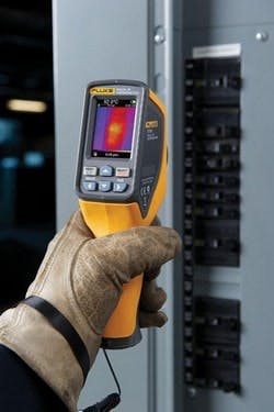

Fluke Corp. introduces the Fluke VT04 Visual IR thermometer, the latest troubleshooting tool with built-in digital camera and thermal heat map overlay that bridges the gap between traditional IR thermometers and infrared cameras. Building on the Fluke VT02, the VT04 adds PyroBlend Plus with a four-times sharper resolution than the VT02 and automatic alarm features. It is a frontline troubleshooting tool suitable for electrical, industrial maintenance, HVAC/R and automotive applications.
The ultra-compact Fluke VT04 is fully automatic with built-in intelligence, so issues can be detected instantly with no training required. The VT04 includes advanced alarm features for troubleshooting stubborn intermittent issues, including a hi-lo temperature alarm that flashes on the screen if the user-selected temperature goes out of the selected range, a time-lapse image capture that can be set to capture images in 30-second to one-hour intervals and an auto-monitor alarm that initiates image capture automatically after a temperature alarm has been triggered, allowing users to automatically capture images — even while the VT04 is unattended — using the universal tripod mount.
It displays and saves images as full digital, full infrared, or in three blended modes (25, 50, and 75 percent) with 40 percent wider field of view than the VT02. Markers pinpoint hot and cold spots indicating the hottest and coldest temperatures on the screen. A temperature reading is provided at the center point. Images are saved to the included micro-SD card, eliminating the need to write down single or multiple measurements. The VT04 Visual IR Thermometer also has a rechargeable Li-ion battery.
