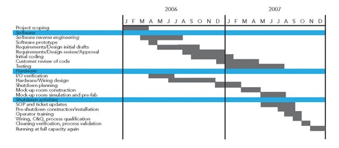

Rough Project Timeline
Figure 1. Project activities took place over a two-year period.Software. The software team comprised two process control engineers from Lilly’s central corporate engineering tech center who were familiar with DeltaV, one plant process control engineer who knew the process and equipment being converted, and several contract system integrators. All assigned internal resources were dedicated to the project and were very experienced with either the existing Measurex DCS and its current operation or the functionality of the new DeltaV DCS. The selected system integrators previously had worked either in the plant being converted or on other corporate DCS projects. The software team prototyped the proposed design; the aim was to be consistent with ISA S88.01 [1] and include all documentation outlined by GAMP [2]. The prototype helped minimize rework by allowing operations, engineering, quality control and the software team to agree on an initial design before large amounts of work were expended. This initial prototype wasn’t a 1:1 conversion of the existing Measurex DCS software. While it was important to retain the knowledge built into the system over the years, it was equally important not to squander opportunities for improvement afforded by implementing a modern DCS. To avoid introducing unintended risks during startup, only improvements that wouldn’t affect the quality of the API were made. For example, when automating a pH adjustment, the team designed an algorithm that mimicked current operator technique. We used many sources, not just the existing Measurex DCS code, to generate the first pass of the requirements and design for the new DeltaV DCS. Other inputs included existing software requirements and design documentation, process historian data, standard operating procedures (SOP) and manufacturing tickets. The process team, consisting of representatives from operations, process engineering and tech service, as well as a dedicated senior operator, then reviewed this documentation in great detail. Once the process team approved the documentation, coding began. The requirements, design documentation and coding standards all were very specific. This specificity resulted in very few surprises with the initial software delivered. The plant automation engineer on the team assessed this software using a process simulator and suggested some changes. Once these were made, the process team examined the software via the simulator. Following this review, the software was formally tested with the process simulator. This served to minimize any surprises during commissioning and qualification.
