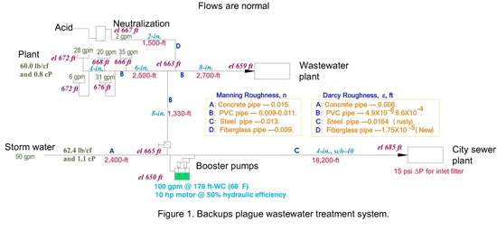

We’re having problems with our plant wastewater system (Figure 1). First, we can’t seem to get the nominal flow out of our new fiberglass neutralization system — we constantly back up in the neutralizer. Second, the drains in the plant are backing up. Our plant manager is convinced we’re seeing overflow from a 4-in. storm-water line that was in use before the process and storm-water treatment systems were separated back in the 1970s. In addition, the city water plant complains that our wastewater is spilling over into the storm water and corroding the line from two sewer sump pumps. What do you think the problem is and what can we do to address these issues?
Process And Storm Sewers
Figure 1. Backups plague wastewater treatment system.
Send us your comments, suggestions or solutions for this question by June 12, 2015. We’ll include as many of them as possible in the July 2015 issue and all on ChemicalProcessing.com. Send visuals — a sketch is fine. E-mail us at [email protected] or mail to Process Puzzler, Chemical Processing, 1501 E. Woodfield Rd., Suite 400N, Schaumburg, IL 60173. Fax: (630) 467-1120. Please include your name, title, location and company affiliation in the response.
