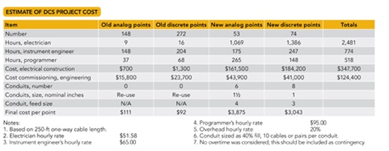

First, let’s consider how best to estimate the cost of basic wiring for analog (4–20-mA control range) and discrete 24-VDC (switch) systems. We’ll ignore the cost of programming today’s advanced control systems, which requires separate evaluation.
Let’s assume typical criteria for the analog wiring: a) maximum voltage line loss of 5% (2% sometimes is maximum); b) 22-mA maximum current required; c) a transmitter loss of 8 V; d) shielded twisted-pair wire; e) a run distance of 3,000 ft (1,500 ft each way); f) no repeaters to amplify the signal; g) two-wire instrument design per ISA Standard 50 (Type II); h) single instruments, no pairs; i) 250-Ω receiver resistance (standard for 1–5 VDC); and j) passive receiver (loop-powered).
Estimate Of DCS Project Cost
Table 1. Cost of new points significantly exceeds that provided by old rule-of-thumb.
My calculation indicates that 16-gauge AWG twisted-pair wire should work. (For the calculation, I used the wire size calculator found at http://bit.ly/2K2iy1I.)
I found a price, including handling, of around $0.47/ft for 16-gauge AWG twisted-pair wire. For 24-VDC signal cable, two-wire 16-gauge AWG runs about $0.35/ft. The next question is trays or conduit? Today, 80% of new installations use trays because they cost about one-quarter that of conduit. However, I think it’s a little short-sighted considering the advantages of conduit — superior signal integrity and less exposure to the elements — especially in hazardous areas. You probably can get by with trays for indoor applications but opt for conduit for outdoor uses.
Assuming this is an outdoor application and uses galvanized conduit, I performed some calculations, which are summarized in Table 1. Here are two key takeaways: 1) each analog point requires an average of about five hours — excluding loop tuning, which likely goes on forever; and 2) each discrete point takes about three hours but doesn’t require tuning.
Note that any commissioning job has a lot of hidden costs. For instance, in-house engineers, because they usually are leery of contract programming, will spend considerable time changing programming, even ripping it out and starting over. My point is that the cost reported by the accountants may not be the real project cost.
Dirk Willard, consultant
Wooster, Ohio
