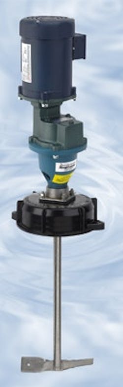

The Neptune Mixer Company introduces the HGL mixer, which operates at 430RPM. The mixers allow easy integration with standard intermediate bulk-containers (IBCs) or poly tote bins with the use of an optional two-inch 316SS bulkhead fitting. The HGL mixer features a short shaft and a folding propeller, both of which are constructed of 316SS and are capable of fitting through a two-inch opening. The propeller's operating diameter is nine inches. A second folding propeller can be added as an accessory and bolted anywhere on the shaft, which measures 3/4 inch in diameter. Motors available with Neptune's HGL Mixer include TEFC electric motors (1/3 to 1 HP) or air motors (1/2 to 1 HP). Explosion-proof motors are also available.
