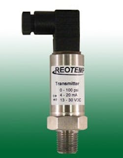

The Reotemp Series TC6 is a general purpose pressure transmitter which meets most accuracy requirements while maintaining a competitive price. It is well-suited to measure compatible gases and liquids with an accuracy of ± 1.0% or .25% full scale. The transmitter converts process pressure or vacuum into a variety of current or voltage outputs.
The Series TC6 is designed for the following applications: compressors, pumping systems, irrigation equipment, hydraulic and industrial process monitoring. It is CE approved with an enclosure rating of NEMA 4x (IP66) and has all 316/316L stainless steel wetted parts. Available ranges include vacuum, compound and pressure (0/5psi to 0/8,000psi). The standard signal output is 4-20mA, with a variety of voltage outputs available. For the process connection, choose from ¼-inch NPT and ¼-inch BSPT (male or female). For the electrical connection, choose between a mini DIN connector, a cable connection or a M-12 4-Pin connection. Reotemp can mount the TC6 to a snubber or diaphragm seal.
