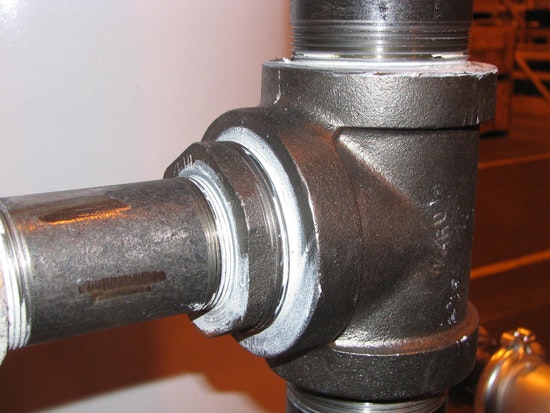

Piping practices suitable for pressure operations often aren’t sufficiently tight for vacuum operation. One common example is the use of threaded connections (Figure 1). While they work well for applications at atmospheric pressure and above, they aren’t good for vacuum because it pulls apart the mating thread surfaces responsible for sealing. The sidebar provides some more tips about piping design, while Figures 2–4 illustrate some proper practices.
Figure 1. Threaded connections shouldn’t be used in vacuum systems unless properly sealed.

  5. Eliminate unsealed threads wherever they are used. They are a large source of leaks. Always remember that whatever leaks into the vacuum system expands greatly. Two ways to lessen the impact of threads are to use a sealer in the gaps of normal NPR threads or use NPT “fine cut” threads.
