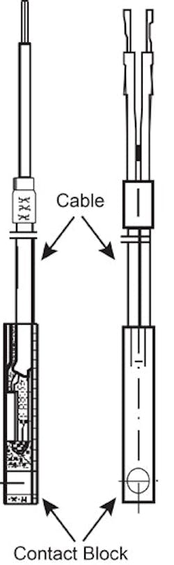

CONTACT BLOCK/PAD
Figure 1. This design suits all surfaces and provides good immunity to the ambient environment.There's also a lower limit on pipe size. It can be very difficult to put a thermowell into a pipe that's only an inch or two in diameter.

Contact block/pad. This simple design (Figure 1) suits all surfaces and provides good immunity to the ambient environment. The sensing element is built into a brass, copper or stainless steel pad that is fastened to the surface by bolts/screws, clamps or welds. Mounting blocks come in a variety of shapes to fit different surface profiles — flat, V-block, radius and custom. The sensing element can be a 2- or 4-wire RTD or a thermocouple. The design can handle harsh conditions, e.g., high temperatures, high humidity or dirt; temperatures can range from 0° to 200°C (32° to 392°F) with conventional cable and from -196° to 600°C (-320° to 1,112°F) with MI cable, depending on the sensor type used.

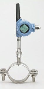

PIPE CLAMP
Figure 3. Bolt-tightened clamps holds the tip of a spring-loaded RTD sensor against the surface.Pipe clamp RTD sensor. This design holds the tip of a spring-loaded RTD sensor against the surface using a bolt-tightened clamp (Figure 3). Mechanically rugged, it can support a temperature transmitter — often a wireless one for an installation where running cable would be difficult or expensive. It is suitable for pipelines, pipe heating systems, flow lines and well heads. Sensors can measure temperatures from –200° to 300°C (-328° to 572°F). Sensor tips are available in silver or nickel for better response time and accuracy. The mounting clamp is made of stainless steel. Insulation patches can be installed between the pipe surface and the clamp itself if there are concerns about contact corrosion.

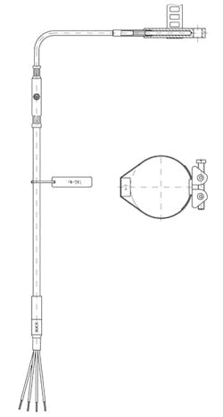

Metal contact block design and worm-drive hose clamp.
This design (Figure 4) is a good solution for round surfaces. It can handle harsh environments with high temperatures, high humidity and dirt. Equipped with an RTD or thermocouple, it can be used at temperatures from –196°C to 600°C (-321° to 1,112°F). The contact block usually is stainless steel or copper.

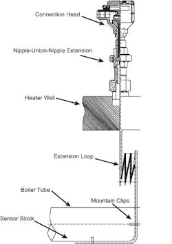

High pressure steam boiler surface temperature monitoring. Measurement was a challenge because of very high mechanical vibration levels, high density measurements with longer length cables, an operating temperature of 600°C (1,112°F), a total temperature range of 0° to 800°C (32° to 1,472°F), and the need for metal-to-metal contact on boiler tubes.
BOILER MEASUREMENT
Figure 5. Contact-block design can tolerate high mechanical vibration and a broad temperature range.
The sensor used is a stainless steel contact block design equipped with a 3.2-mm Type K thermocouple. This is mounted with clips to a boiler tube (Figure 5); a MI expansion loop handles issues of expansion and contraction without damaging the sensor. The sensors are connected to a high density temperature transmitter.
Benefits include accurate boiler fatigue calculation, early detection of boiler tube failures and hot spots, reduced boiler operating and maintenance costs, increased sensor life under harsh conditions and lower cabling costs.
