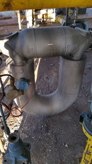

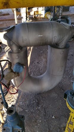

Coriolis Meter
Figure 1. This flow meter has enabled a better mass balance, leading to significant improvement in plant efficiency.

A good mass balance is vital for such complex plant processes; achieving that balance requires accurate and reliable flow measurement. However, the differential pressure (DP) flow meters that we were using demanded frequent maintenance because process fluids sometimes polymerized inside the meters, clogging impulse lines, which led to bad measurements.
Starting in 2008 and wrapping up in 2010, we replaced the unreliable DP meters with Micro Motion Coriolis flow meters from Emerson Process Management (Figure 1). These devices provide accurate and reliable measurements of mass flow, unaffected by changes in pressure and temperature. In addition, the meters have no moving parts to wear or fail, which allowed us to significantly reduce maintenance requirements.
The meters have improved mass balance in unit operations for the production of MTBE and butadiene, where they handle flow and concentration measurement. By achieving the required mass balance, we avoided 150 mt of product loss every month — with a value of €700,000/y ($760,000/y). Based on current production figures, this saving translates into a 2% increase in overall plant efficiency.
