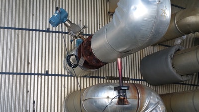

Figure 1.   Teaming of wireless transmitter with energy harvester provided an ideal solution for gathering data.

The addition of flanges created the option for direct flow measurement — at a time the Rosemount unit of Emerson was looking for a beta tester for an experimental design that allowed top mounting of a differential pressure (DP) flow transmitter to a type-405C stainless-steel conditioning orifice plate in steam service. The Rosemount 3051 DP transmitter design avoided the need for heat-traced impulse lines. The wireless transmitter enabled getting flow measurements with minimal effort and installation cost.
The desired frequency of data readings from the flow meter raised an issue, though. A 4-sec update rate would require frequent battery maintenance in the extremely hot, hard-to-access location. With pipe temperatures greater than 500°F, the air temperatures around the transmitters easily could exceed 140°F. Given the high temperatures, the risk of burns and heat stroke are ever present. Even the toughest instrument technician was challenged during the initial equipment installations.
Looking for a way to tackle the battery replacement issue, the plant decided to explore the use of Power Puck thermoelectric energy harvesters. These small devices feature protruding heat-sink bristles and convert the heat flow from temperature differences directly into electricity. With heat sources ranging from “warm to the touch” to hot steam pipes, Power Pucks generate enough electricity to fully power the most-popular wireless transmitters for many years, eliminating the need for battery replacements. As long as a temperature difference is present, the thermoelectric energy harvester powers the transmitters; the battery is preserved for operation during turndowns and other occasions when a loss of process heat occurs. The devices are intrinsically safe and easy to install.
The plant installed a demonstration unit in November 2014that harvests heat from the steam lines. That Power Puck was a success. It has prevented equipment failures and also improved worker safety by eliminating the need to service batteries in high temperature locations only accessible with scaffolding.
Plant staff feel teaming the Power Puck with the Rosemount 3051 transmitter (Figure 1) has been very beneficial. They are impressed with the resiliency and ruggedness of the wirelessHART 3051 and the Power Puck in this harsh service — one that provides accurate steam flow measurements while extending the period for battery changes by many years. Now, the transmitters and Power Pucks can be ordered together directly from Emerson.
