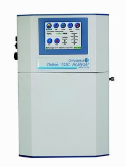

Xylem has launched the 9210p on-line TOC (total organic carbon) analyzer for routine monitoring and regulatory compliance reporting in drinking water. The 9210p provides real-time data and visibility of natural organic matter that reacts to form harmful disinfection byproducts. All public water systems must comply with U.S. EPA regulations by Oct. 1.
