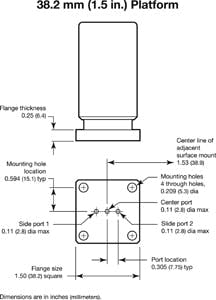

Figure 1. Standards for dimensions enable easily switching single devices without need to modify others. Derived with permission from ISA, www.isa.org.

In August 2002, a 1½-in. square NeSSI component footprint for the fluid rail was adopted in the ANSI/ISA 76.00.02 standard, which defines properties and physical dimensions for surface-mount fluid distribution components (Figure 1). This fixed footprint enables changing a single element without having to modify the entire system, streamlining design and maintenance.
