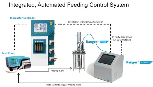

Figure 1. Probe provides real-time data that analyzer uses to generate a control parameter for nutrient addition.

The Ranger system (Figure 1) consists of a Ranger Probe, which is mounted within a bioreactor, and a Ranger Manager, which takes the real-time data, referred to as the process trend index (PTI), from the probe. The Ranger Manager applies sophisticated mathematical methods to analyze the PTI to generate a control parameter reflecting the metabolic activity, referred to as the metabolic rate index (MRI). This MRI control signal triggers a feed pump, which delivers, nutrient-rich media additions to the bioreactor. The closed-loop control is fully automated without the need for manual intervention.
Other sensors measure specific parameters such as temperature, pH and dissolved oxygen that often are used to control the physical state of the reactor but no other sensor provides a real-time view of the process metabolic activity.
