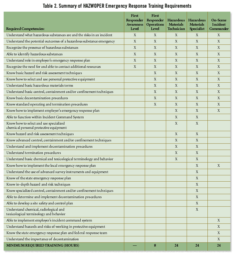

Training requirements
The HAZWOPER standard establishes five basic training requirements related to chemical emergency response: the First Responder Awareness Level, First Responder Operations Level, Hazardous Materials Technician, Hazardous Materials Specialist, and On-Scene Incident Commander training. These training levels are based on an emergency response. A summary of HAZWOPER emergency response requirements is provided in Table 2.
First Responder Awareness Level training is required for individuals who are likely to witness or discover a hazardous substance release and who would take no action beyond notification of the proper authorities. Even if you do not have a spill team and do not plan to respond to spill emergencies, your employees might need First Responder Awareness Level training. This training potentially could include everyone from the chemical operator to the security guard, mail clerk and salesperson. The standard specifies six areas of competency that must be achieved either through training or experience, including understanding the risks associated with a hazardous substance incident.
Elements of First Responder Awareness Level training are similar to Hazard Communication, DOT General Awareness, and Resource Conservation and Recovery Act (RCRA) Spill Prevention Control and Countermeasures (SPCC) training. Many elements of these training programs can be integrated to avoid duplicate training.
However, facilities must address the elements unique to each regulation. Important elements of First Responder Awareness Level training are the ability to determine the need for additional resources and the ability to make appropriate notification to the communication center.
First Responder Operations Level training is required for individuals who respond to releases or potential releases as part of the initial response. They are trained to respond in a defensive manner to protect people, property and the environment.
Defensive actions are those taken from a safe distance to keep the spill from spreading and to prevent exposures. Examples include covering drains, placing spill booms or barriers and barricading access points ," all from safe distances.
Eight hours of training or sufficient experience to demonstrate competency is required. The areas of required competency include hazard and risk assessment techniques, selection and use of personal protective equipment, spill control and containment, decontamination and standard operating procedures.
Hazardous Materials Technician training is required for individuals who will respond to the release or potential release for the purpose of stopping the release. They usually will be close to the source of the release and, therefore, have a high potential for harmful exposures. Examples include overpacking a leaking drum or collecting contaminated absorbents.
The investment in training, as well as in procedures and equipment, substantially increases when moving up to this level of response. The facility will need to train and equip enough people, including hazardous materials specialists and an incident commander, to meet a variety of requirements.
The Hazardous Materials Technician level calls for 24 hours of training. Personnel also must demonstrate competency in several areas, including the emergency response plan, instrumentation, the incident command system, selection and use of personal protective equipment, hazard and risk assessment, containment and control, decontamination, termination procedures and basic chemistry and toxicology.
Hazardous Materials Specialist training is similar to the Hazardous Materials Technician training. However, the specialist is required to have greater knowledge of the chemicals to which he or she might respond, as well as to act as a liaison with governmental authorities. He or she also provides support to the hazardous materials technician.
Twenty-four hours of training is required. Areas of required competency include those required of the hazardous materials technician, plus an understanding of the state emergency plan and in-depth hazard and risk assessment techniques. He or she also must be able to determine decontamination procedures, develop a site safety and control plan and demonstrate a greater knowledge of chemistry and toxicology.
On-Scene Incident Commander training is required for response beyond the First Responder Awareness Level. The role of the incident commander is to assume control of the incident scene. The incident commander must be someone on-site who is designated and trained to be in charge of the incident.
The required training will vary with the level and complexity of the response. The minimum required training is 24 hours, including at least First Responder Operations Level training. Competency must be demonstrated in implementation of the incident command system, the employer's emergency plan and the local emergency plan. He or she must understand the hazards and risks of working in personal protective equipment and the importance of decontamination.
The OSHA training requirements are a minimum. Based on the nature of your facility and its hazards, additional training could be necessary.
All levels of training require annual refresher training or a demonstration of competency. Drills and other activities can be used to demonstrate competency.
By allowing a HazMat team to respond to nonemergency spills, a facility provides an excellent way to maintain skills that would be needed in an emergency. Whatever you choose to do, you must remember to document the training and competency evaluations.
On-Scene Incident Commander Training includes details about the hazards and risks of working in personal protective equipment.
