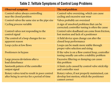

Among the conditions that reduce process efficiency are improper control valve selection, sizing or calibration; instability or oscillation above and below the setpoint; slow response to changing conditions; or a combination of these factors. Numerous plant audits have shown roughly one-third of all installed control valves operate at substandard levels, even though properly operating valves are essential to overall plant efficiency and product quality.A study performed by Entech Control Inc., Toronto, identified common problems found in control loops. (See Table 1). Some 80 percent of the control loops studied contributed to increased variability. Table 2 details some common symptoms of control loop problems.

Many process engineers look at control valves as low-tech iron that simply controls fluid flow. However, control valves are actually among the most complex field devices. They repeatedly are required to perform rigorous tasks, often under extreme service conditions. Because many control valves are in motion continuously, they can reduce process efficiency drastically if improperly designed, installed and maintained. When a concerted effort is made to understand the performance of these final control elements, process variability can be reduced. Control valves need to respond quickly and accurately to control signals if a corresponding improvement in loop performance is to occur.Another very common symptom is that controllers are placed in manual instead of automatic operation. Although many other reasons could exist, control valve problems are the root cause in many cases.Too few technicians really understand the value of improving loop performance. Although many case studies show better performance of a critical loop produces significant operational benefits, less-obvious problems go unnoticed and unattended. More action is needed for the large number of loops considered less important because improvements made to a large number of these loops could magnify the financial benefit. These improvements become possible and commonplace once plant personnel have the knowledge and skills to troubleshoot problems and implement solutions.
